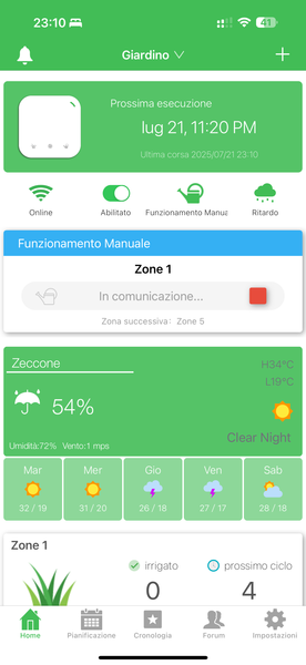

Hi everyone,
I’ve been using a Netro Spark (8-zone model) for some time, but recently it stopped working properly.
The controller connects to Wi-Fi and appears online in the app, but when I try to start any valve (manually or via schedule), it says “communicating” and nothing happens.
Here’s what I’ve already tried:
  • Restarted the Spark multiple times
  • Performed a full reset (12 seconds on RST button)
  • Re-added the device in the app
  • Tried to trigger irrigation manually from both the app and the controller
  • Confirmed that the system works when I open the valves manually from the controller
  • Tried different power supplies
  • Connected to a mobile hotspot instead of my home Wi-Fi (same result)
  • Updated the firmware to the latest version (v3.3.0)
  • Purchased a brand new Spark controller and tested it — same exact issue
At this point, it looks like the issue is not hardware or network-related.
Could it be a firmware bug or a server-side problem?
Any help would be greatly appreciated!

Hi everyone,
my Netro Spark 8 controller connects correctly to Wi-Fi and shows as online in the app. However, when I try to start irrigation manually from the app, it just stays on “in communication” and nothing happens.
I’ve already tried:
  • Using a different Wi-Fi network (even a mobile hotspot)
  • Replacing the controller with a new Spark 8
  • Restarting both the app and the device
If I activate the valves directly from the controller, they work fine — so it’s not a hardware issue.
Any suggestions on how to solve this?
Thanks in advance!
